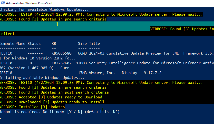

    I didn't have any problem with the brackets on Win10/PS5.1, but -AutoReboot:$false did not work. I get a prompt.
    -IgnoreReboot appears to work. I need to verify on another VM.

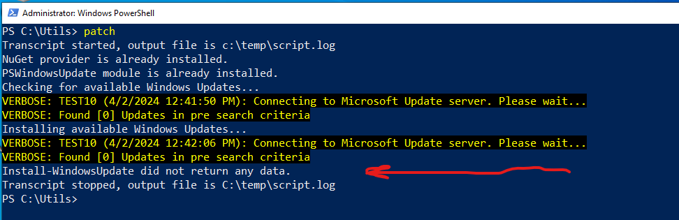

    After a reboot, when I rerun the script I get this.
    Here is the script that I used. Updated on 4/3..

    if (!$Update) {
       $Update = "Install-WindowsUpdate did not return any data."
    $Update | format-table -wrap | Out-File -FilePath $op
    get-content $op                     # record in transcript
    Stop-Transcript

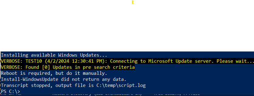

    I would recommend that you do a reboot in case you have updates installed and waiting to to be implemented and/or other powershell.exe processes waiting for someone to type in y/n.

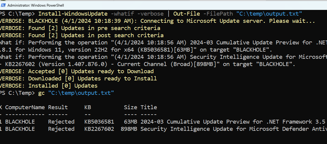

    Don't use a pipe. Assign the output to a variable and then examine the variable.
    I would also suggest writing to some folder other than the root of C:.
    Add the "-verbose" switch to the install cmdlet and see if that produces any additional info.
    $x = Install-WindowsUpdate -AcceptAll -AutoReboot:$false -verbose
    "Here is the type."
    $x.gettype()
    "Here is the x variable."
    $x
    $x | Out-File -FilePath "C:\windows\temp\output.txt"
    Add a transcript if the verbose output is not captured.
    https://learn.microsoft.com/en-us/powershell/module/microsoft.powershell.host/start-transcript?view=powershell-5.1
