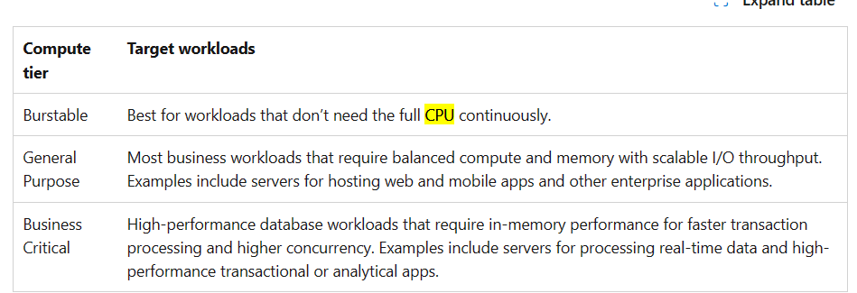

    I would suggest to first review your workload and considering using a different tier from Standard_B1s if you need stable performance all the time:
    Azure Database for MySQL - Flexible Server service tiers
