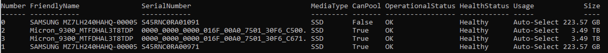

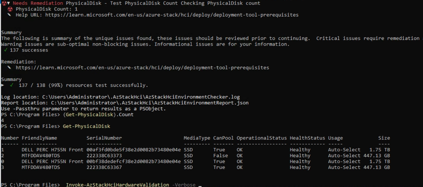

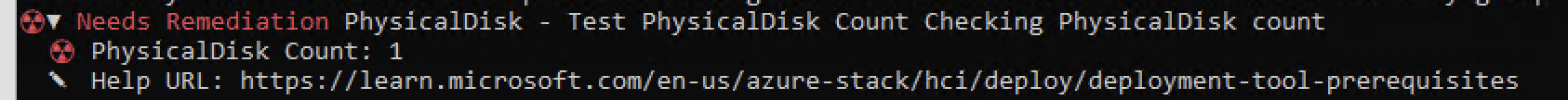

my doubt is that by executing the
Get-PhysicalDisk command, it lists 4 disks but when I run the execution process it only lists 1, can you help me?

    Based on your question and what I saw from your screenshot image. The probabilities are you're having one physical disk with virtual disks. Either 1 Physical disk and 3 volume disks(partitions) or 2 Physical disks with 2 Virtual disks, and only 1 physical disk that's accessible during execution.
    Reasons, while observing your disks 0 and 1 are of the same name and size, if they are different, that's improper disk naming. Also, your disks 2 and 3 are of the same name and size, if they are different, that's improper disk naming. The serialNumber of the disks might be different though almost similar, virtual machine can do that.

    I'm not sure if I am fully understanding your issue, but I did want to clarify that RAID is not supported for the storage disks in Azure Stack HCI. This can be seen in the Server and storage requirements section of the System requirements for Azure Stack HCI, version 23H2 doc. Note that this requirement applies to 22H2 as well. Any host-bus adapters (HBAs) must implement a simple pass-through mode to be supported.
    Also, the output from Get-PhysicalDisk will show your OS and storage drives. But the environment checker is only going to report disks that are able to be used within the storage pool. The minimum number of drives required vary based on the type of cluster you are deploying. The same Server and storage requirements section notes that Azure Stack HCI requires a minimum of two physical disks each having at least 500GB in capacity. As such, if you have two 1.92TB SSDs in each server, this should meet the requirement so long as they are not being used as RAID and the HBA they are attached to allows pass-through mode.

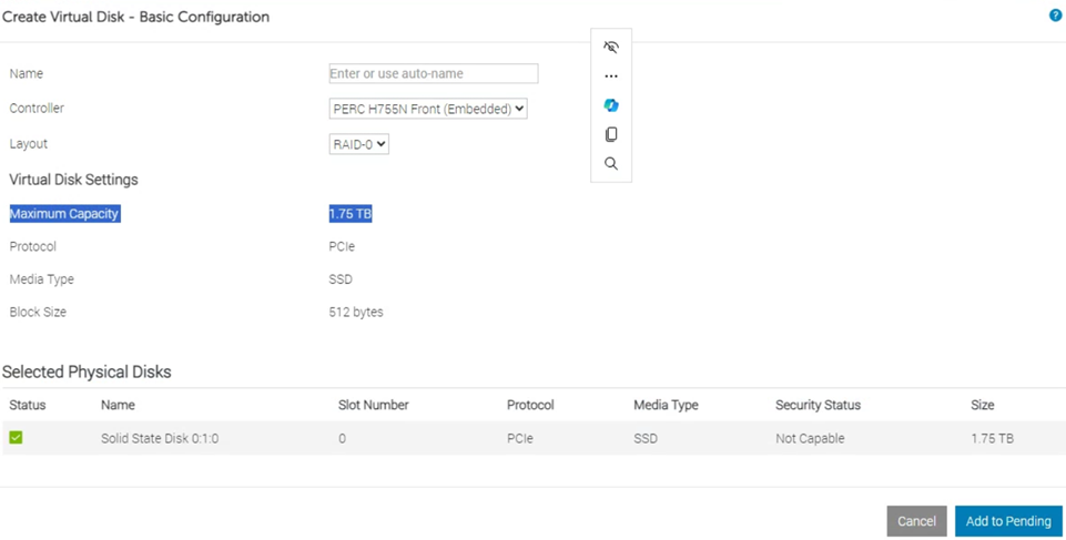

    Hello good afternoon thank you very much for the answer, I'm trying to configure the disks from the dell idrac configuration to inicilizar disks only lets me raid0 to then be able to see them know another option.
  3. Luis Antonio Orellana Barre 20 Reputation points
    2024-04-10T15:03:04.9866667+00:00
    User's image although this is more dell than microsoft when I configure the disks it only lets me configure them in noraid or raid0 I have tried both configurations but it keeps giving me errors

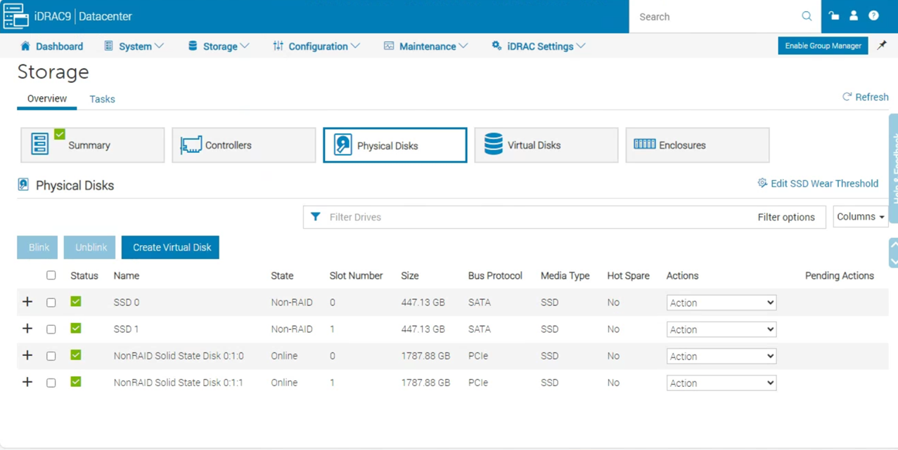

    I'm getting the same one. Here is my screenshot. I have no raid enabled in my iDrac/BIOS:
