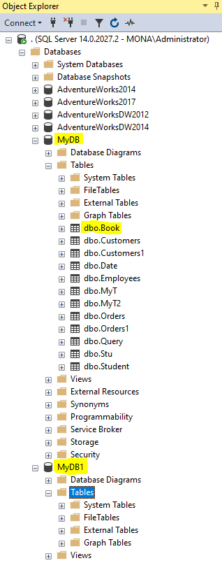

  2. Monalv-MSFT 5,926 Reputation points
    2020-11-17T03:24:53.41+00:00
    Hi @Didiiolu ,
    Could you please share the error messages in detail?
    Please run the following sql command in SSMS:
    USE MyDB;   /* DataBase1: MyDB */
    USE MyDB1;   /* DataBase2: MyDB1 */
    SELECT * INTO MyDB1.dbo.Book FROM MyDB.dbo.Book;
    Hope the following link and pictures will be helpful:
    How to copy tables from one database to another in SQL Server
    Best Regards,
    Mona
