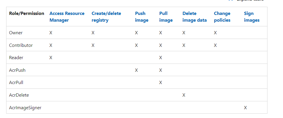

  4. Deepanshu katara 18,140 Reputation points MVP Moderator
    2024-04-05T10:44:58.1533333+00:00
    Hi Deepankur, Welcome to MS Q&A
    Can you please verify that the managed identity assigned to your container app job has the necessary permissions to pull images from the Azure Container Registry. The managed identity should have the "AcrPull" role assignment on the ACR
    Please check this img and doc for more details--> https://learn.microsoft.com/en-us/azure/container-registry/container-registry-roles?tabs=azure-cli
