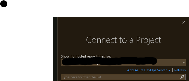

    For an Azure DevOps Server instance go to Team \ Manage Connections. Click the Manage Connection link and it'll pop up the Connect to a Project UI.
    enter image description here
    Click the Add Azure DevOps Server link and type in the URL to your local instance. It will show up in the tree view along with all the other source control instances you are connected to.
