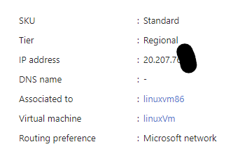

      Can you share a screenshot of the Public IP from the Azure Portal, like below?
    I would suggest you to please double-check your logs and give us more information as to what the exact issue is.
