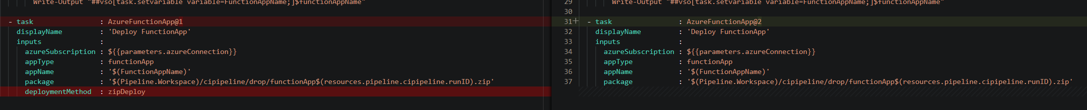

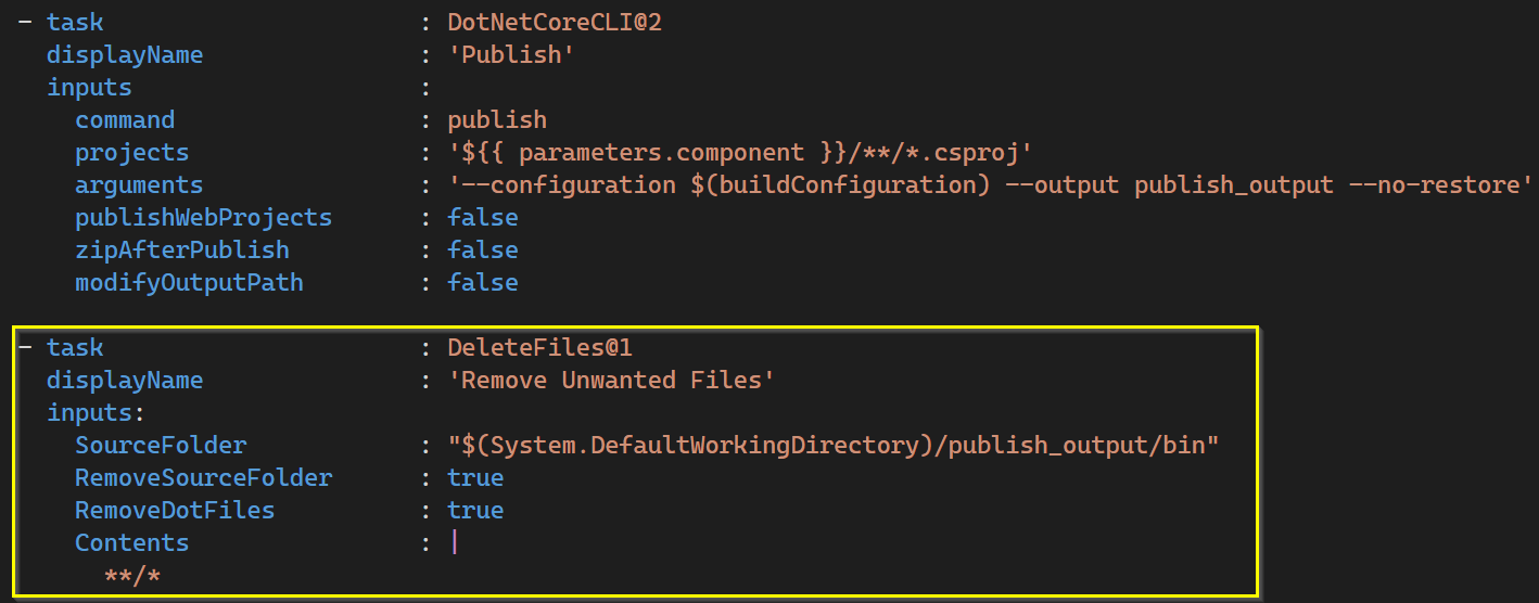

    1. My DotNet Publish step was creating extra bin folder inside publish folder so I added extra step to my build pipeline to remove bin folder before packaging it.
    1. I updated my AzureFunctionApp task to version 2 and removed deploymentMethod property. User's image

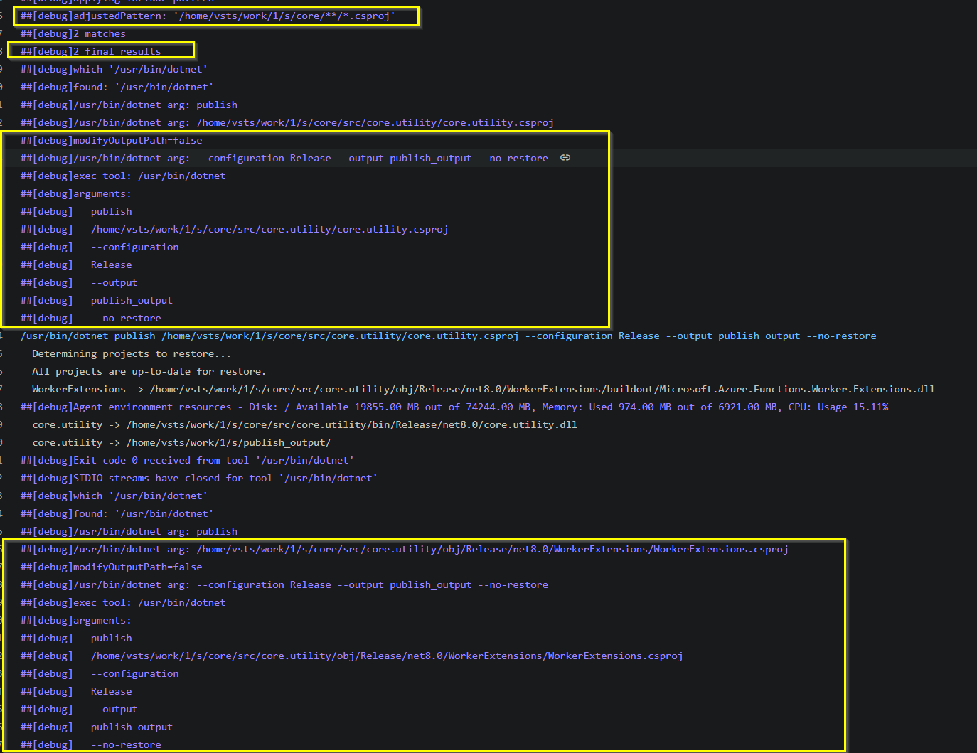

    2. Also noticed that if you are running DotNet Publiush after DotNet Build step in your build pipeline and using *.csproj filter to find csProject file, it's finding two csprojects. It's the WorkerExtentions project puslish overwriting my previously published files. I have to update my csProject filter search so that it only finds one csProject. User's image
