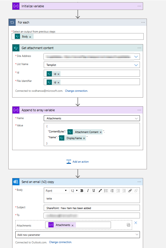

    • First, you need to create a connection between Azure Logic App and SharePoint. To do this, go to the Azure portal and navigate to the Logic App that you want to use. Click on the "Logic App Designer" tab and then click on the "New step" button. Select "Add a connection" and then select "SharePoint". Follow the prompts to sign in to your SharePoint account and create the connection.
    • Once you have created the connection, you can add a trigger to your Logic App. Select the "When an item is created or modified" trigger and then enter the Site Address and List Name for the SharePoint site and list that you want to monitor. If you don't know the Site Address and List Name, you can find them by navigating to the SharePoint site and list in your web browser and copying the URL. The workflow is triggered when a new item is created in a SharePoint list.
    • Retrieves the attachments of the new item using the "Get_attachments" action.
    • Loops through each attachment using the "For_each" action.
    • For each attachment, the workflow retrieves its content using the "Get_attachment_content" action.
    • Send an email using the "Send_an_email_(V2)" action, with the attachment added to the email as an attachment and the email body and subject specified in the action.
    • Finally, save and run your Logic App to test it.
    Screenshot of Logic app:
    Sample code reference:
