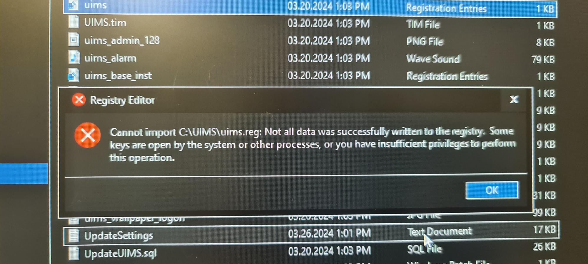

Hello Everyone,
I am not able to run .reg script in regedit as a local account/user. But only by granting Administrator privilege.
How can I grant privilege to local account/user to execute .reg script without administrator privilege?
Best Regards
Ajith
