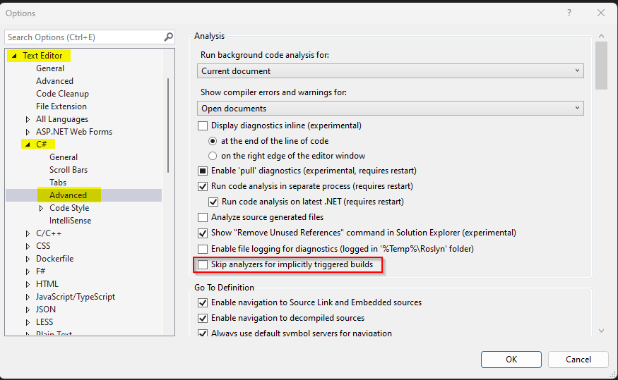

  2. Fabrizio Mancin 0 Reputation points
    2024-05-07T07:47:56.8366667+00:00
    I found the solution by myself unchecking the box below
    VS 17.9.6
