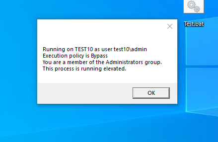

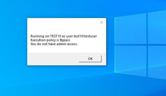

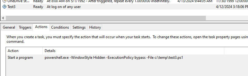

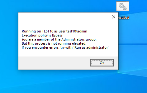

    I defined the scheduled task to run as the Builtin\Users group and set the trigger to the "Log on of any user".
    When any user logs on, I see a Powershell window briefly pop up and then go away due to using -Windowstyle Hidden.
    When a non-admin logs on, it shows this msgbox.
    Depending on the "Run with highest privileges" check box, an admin gets one of these.
