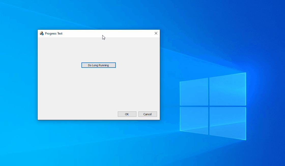

    Option 4 to run a progress dialog on a separate thread can be done with MFC. However, while the progress dialog will be unencumbered by the long-running operation on the UI thread the need to pump messages on the UI thread remains. In the illustration below, the simulated long-running operation does not pump messages so Windows will show that the main window is not responding. The progress dialog continues until the long-running operation is completed or cancelled.ThreadedProgress
    You can find guidance for MFC and Mulltithreading here - Multithreading with C++ and MFC

    Hi all - thank you for your answers, but especially RLWA32. I am inclined to go for option 4 and put the progress dialog on a second UI thread. It's a good point that you still need to pump messages on the main GUI thread to prevent Windows thinking that it's 'not responding'. But the pumping wouldn't have to be nearly as frequent as would be needed to get a smooth scrolling marquee; so I still think this is a good option.
