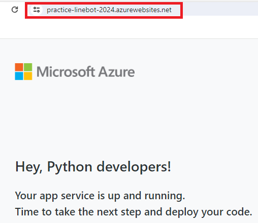

    @世霖 趙 , From your webapp URL
    https://practice-linebot-2024.azurewebsites.net/ , I see that it's displaying default app (screenshot below).
    The default app appears because you either haven't deployed your app code to App Service, or App Service failed to find your app code and ran the default app instead.
    If the App Service doesn't find a custom command, ( your Flask app), then it runs a default read-only app, located in the opt/defaultsite folder
