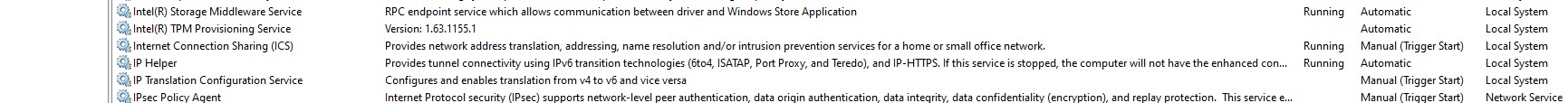

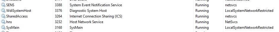

    2024-04-18T03:45:10.86+00:00
    Hell,
    SVCHost.exe is indeed an integral part of Windows, which is used to host multiple Windows services. Blocking entire svchost.exe may have undesirable effects because multiple services use this process, some of which are critical for the system to operate correctly.
    One approach would be to find the specific service within the group of services hosted by the svchost.exe process that’s locking port 67.
    Command Line: Use the command tasklist /svc /fi "imagename eq svchost.exe" in the Command Prompt to view the services running under each svchost.exe process.
    Once you’ve established which services are part of the problematic svchost process, do a bit of research on what each of them does. One of them may be tied to network communications (like DHCP Client, DNS Client, etc.,) which might be the culprit causing your issue.
    If you determine one of them is unnecessary, you can proceed to disable it:
    Run ‘Services.msc’ from Run window ( Win + R ).
    Find the service you suspect from the list.
    Right-click and open ‘Properties’.
    Stop the service and then set the ‘Startup type’ to ‘Disabled’.
    In case it’s a Windows service related to a recent update that’s causing the issue, you might consider uninstalling that update.
