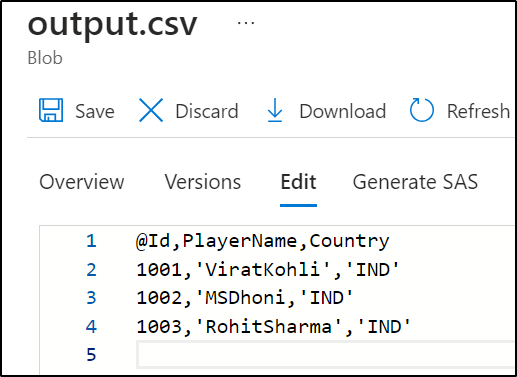

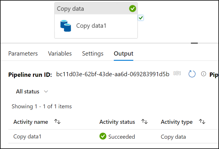

    I tried to create a sample csv file having first column as '@ID' and copied the file from one container to another using copy activity. It worked without any error.

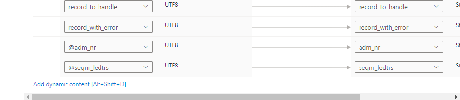

    In case you are trying to copy from csv(ADLS) to SQL table, you could try mapping the column to remove @ in the target like below: @ sign in columnname
