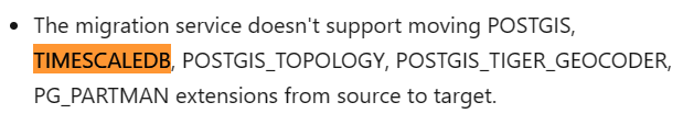

  2. GeethaThatipatri-MSFT 29,587 Reputation points Microsoft Employee Moderator
    2024-04-17T16:10:03.45+00:00
    Hi, @Michiteru Sugitani Thanks for posting your question in the Microsoft Q&A forum.
    As per the document you can't move extensions not supported by the Azure Database for PostgreSQL – Flexible server. The supported extensions are in Extensions - Azure Database for PostgreSQL.
    https://learn.microsoft.com/en-us/azure/postgresql/migrate/migration-service/concepts-known-issues-migration-service
    Please let me know if you have any additional questions.
