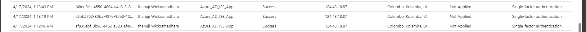

Then I was going to integrate azure AD and Duo. The integration between azure and duo also successful. Also, I applied the conditional access policy if user sign in to previously registered app required duo MFA. But in azure sign in log, it shows as the conditional policy not applied and sign in state as success.
But conditional policy is correctly configured I test with try to login to app using URL then it required Duo MFA. Here user will still authenticate using azure credentials without Duo MFA.

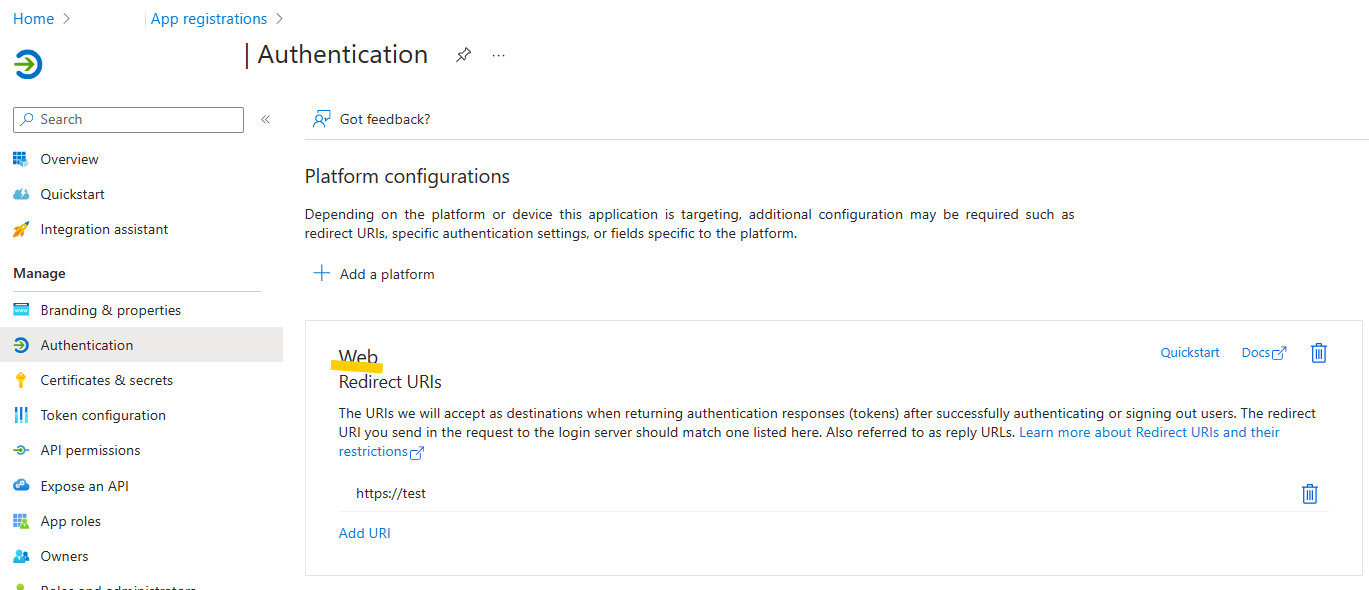

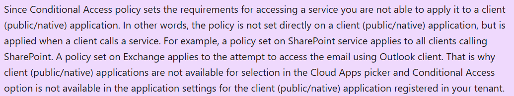

    I'd suggest you to check whether your application is registered as a Web Application or as a Public / Native Application. CA policies are not applied to public apps as per the document below:
    https://learn.microsoft.com/en-us/entra/identity/conditional-access/concept-conditional-access-cloud-apps#other-applications
    This is where you can confirm how your app is registered:

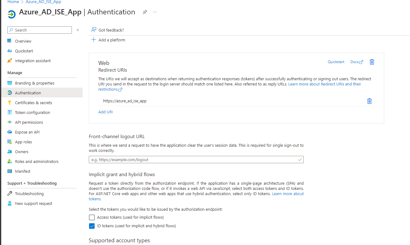

    Hi @ Fabio AndradeScreenshot (179)
    Thank you for your response.
    I am already enabling web redirect URL application is shown in cloud app picker while adding conditional policies. Using URL when I am connecting to app conditional policy applied and Duo MFA required. But when I am connecting to SSID still Duo MFA not required. For that way still conditional policy not applied. Since this is ROPC for while connecting to SSID is there any possibility to add MFA as this way?
