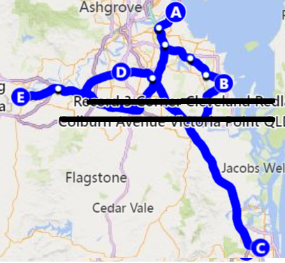

We are using the following MIO API to generate the schedule.
https://learn.microsoft.com/en-us/bingmaps/rest-services/routes/optimized-itinerary
It's working fine, but some of the records are not generating the proper schedule.
When we schedule 4 records , it generates the following schedule.
test
We found that the difference is that it should go to E first, then D, and finally to the End location. However, it goes to D first, then E, and finally to the End location, which is the reason for the increased time. To generate the schedule, we pass records to MIO, which then generates the schedule. We are currently checking if there is any parameter or way to obtain the best possible route.

    Shortest path calculations (Travelling Salesmen) use a lot of compute fast and with each point added, the time to compute grows exponentially. As such a heuristic algorithm is used to estimate the shortest path through a network. Since this is an estimate, it may not find the perfect shortest solution, but one that is one of the shorter possible options. This is just how heuristic algorithms work, and any other method would take too long when you add more points. The MIO API was designed with the idea that there would be a lot of points being submitted. If you are only submitting 5 points, the brute force calculation for shortest path doesn't take that long and could be done in code and give the perfectly optimal solution. A couple of options to try if you have a small number of points (less than 10):
