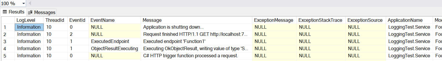

I have a simple dotnet-isolated Azure function written in .Net 8 which has 1 Http trigger function. I have another custom database logger which is added to this function to enable database logging.
When I am executing the function, none of the Microsoft related logging are getting filtered and it's logging hundreds of entries in my database. I have already tested my custom logger with a simple console application where the logging filtering works correctly. What's interesteing is apart from my own custom logger, the console logs are also not getting filtered.

Still it shows Log entries in Console and Database.
enter image description here
Is there anything wrong with my host.json?
