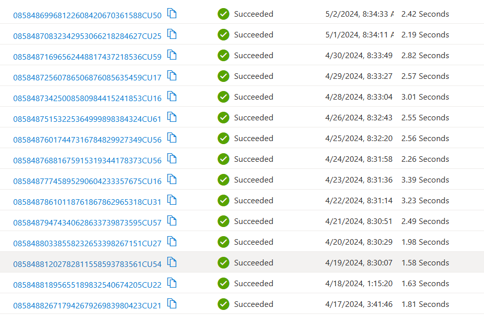

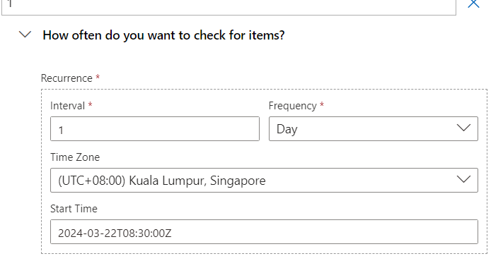

In logic app designer, the recurrence start time is set to 8:30AM UTC+8:00 but it is running at 11:15AM UTC +8:00. Please refer screenshot below.

    As per your screenshot I can see that you StartTime field has the vale ending with Z.
    If you select a time zone value, you don't need to add a "Z" to the end of your Start time value. If you do, Logic Apps ignores the time zone value because the "Z" signifies a UTC time format.
    So, you need to remove the Z from your start time property.
    In your case your logic app first run will start at 8:30 am UTC. Now the second issue why your run history shows the time as 11:16 AM right now rather than 8:30 AM. This is because when if don't specify any other advanced scheduling options, such as specific times to run future recurrences, those recurrences are based on the last run time. As a result, the start times for those recurrences might drift due to factors such as latency during storage calls.
    In the above case you should also define the hours property to 8 and minutes property to 30 so your flow should execute every day at 8:30.
