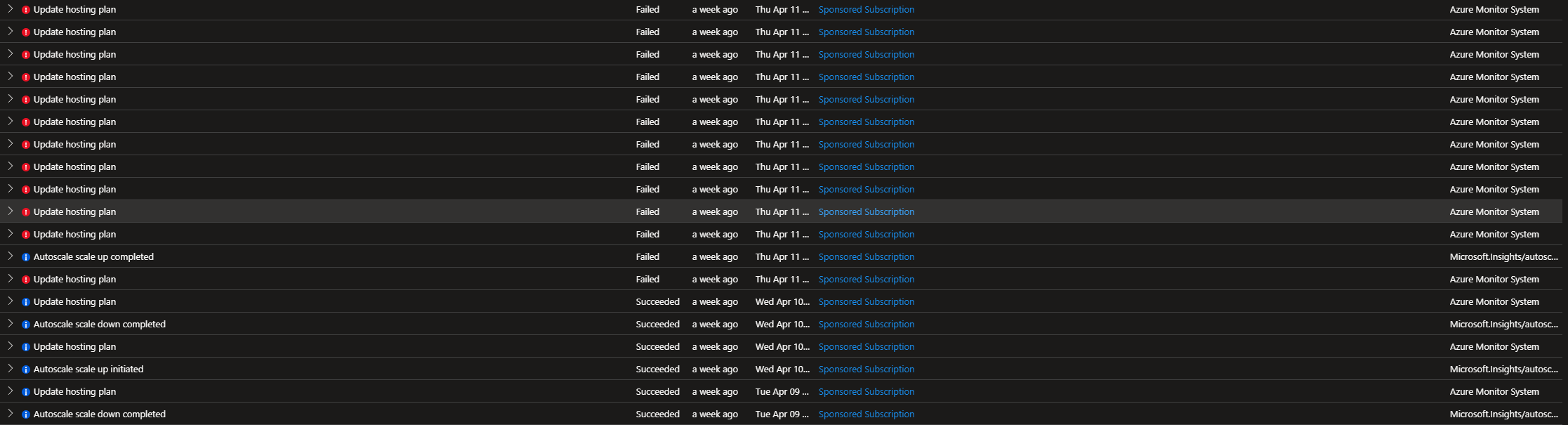

Other issues - We had our app service plan set to Automatic Autoscaling between 1 and 4 instances.
Starting on 11th April we started getting errors from the autoscaling:
Thinking this could be related I swapped temporarily over to a flat 2 instances when my users started reporting the 502 errors. They continued to occur. When I attempted to turn autoscaling back on my instances were marked as unhealthy and I got the 502 trying to visit the site so I put it back to manual 4 instances.
