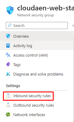

  2. Dillon Silzer 57,831 Reputation points Volunteer Moderator
    2024-04-20T06:10:16.6666667+00:00
    Hi Pascal,
    Ensure you have the necessary ports open on your Azure VM's Network Security Group (NSG):
    Go to the Resource Group > Find the NSG associated to the VM > go to Inbound security rules:
    Ensure you have added a rule to allow port 80 and 443 (and any other port you may have configured on the server to allow traffic to the server).
    If this is helpful please accept answer.
