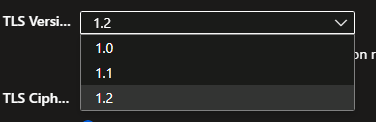

How to force the use of TLS 1.3 in the App Service(Azure)?
Santos Reyes 20 Reputation points
2024-04-20T01:54:29.4166667+00:00
Azure App Service
Azure App Service
6,900 questions
  1. TP 76,601 Reputation points
    2024-04-20T03:14:12.9266667+00:00
    You can't set it via the portal (not yet, coming soon), but you can using powershell commands in Azure Cloud Shell, see sample below:

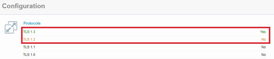

    After making the change you may verify minimum TLS using below:
    https://www.ssllabs.com/ssltest/analyze.html
    Once the test is complete, scroll down to Configuration section of the results, and confirm that TLS 1.3 = Yes and TLS 1.2 = No, indicating that TLS 1.3 is minimum required, as shown below:
