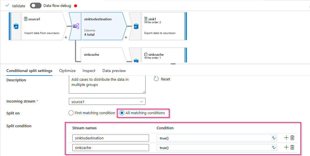

    • Start by using a conditional split on your input data. This will split your data into two branches, each containing the same information.
    enter image description here
    • Assign one branch to the sink and set up the cache as shown below.
    • In the original sink, transfer your data to target and the second sink is used for sink cache. Give the sink write order for the dataflow.

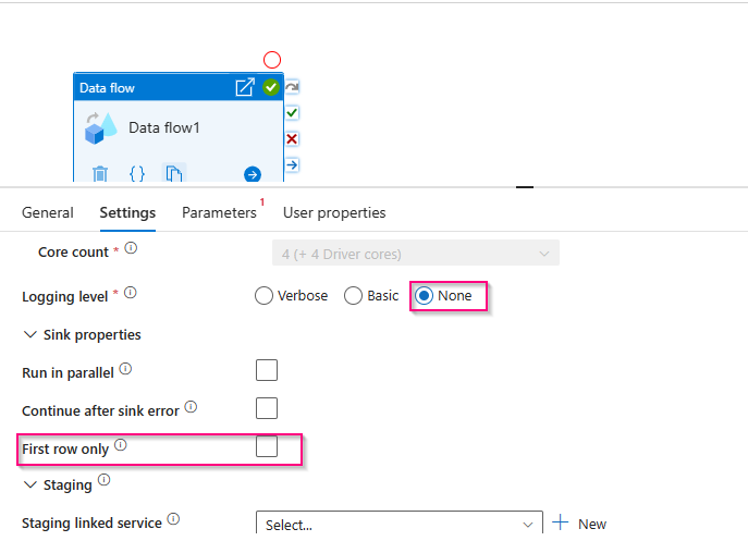

    • In the dataflow activity, set the logging to None and uncheck the First row only.

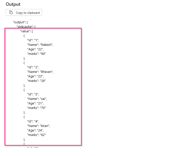

    • In the dataflow activity output, you can see the second sink output array.
    • To access the above output array, use the below dynamic content in a set variable activity after the dataflow activity in the pipeline.
    Later, you can use this array to get the data for your variable as per your requirement.
