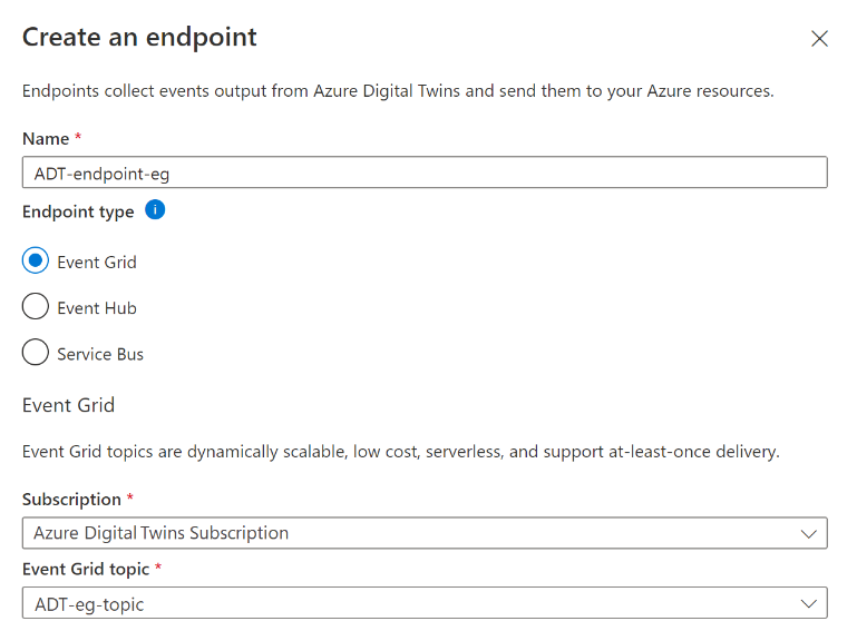

    Luckily, the ADT environment exposes any Digital Twin changes via 'endpoints'.
    Routing event notifications from Azure Digital Twins to downstream services or connected compute resources is a two-step process: create endpoints, then create event routes to send data to those endpoints.
    So you need to create an endpoint (eg. to EventGrid, EventHub, or Service bus) and route message towards it:
