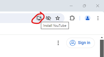

Just need your help please. We have a few users who has downloaded the Youtube App from Chrome. It can be downloaded by going to Youtube.com using chrome and clicking on this icon located on the top right corner.
It can be installed without admin permissions and we want to uninstall this and hopefully block users from installing this.

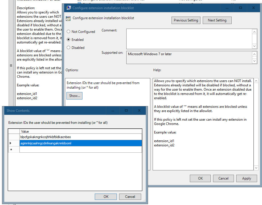

  1. I have tried to use this GPO called Configure extension installation blocklist. Enabled this and added the youtube app-id and the extension id i found in google.
Agimnkijcaahngcdmfeangaknmldooml
blpcfgokakmgnkcojhhkbfbldkacnbeo
Any other ideas or suggestions you can recommend? i can confirm i dont have any other conflicting gpos here.

    Configure GPO to Block Extensions:
    You mentioned configuring "Configure extension installation blocklist." This should work, but make sure you've enabled the policy and added the correct app IDs. Recheck the IDs for the YouTube app:
    agimnkijcaahngcdmfeangaknmldooml
