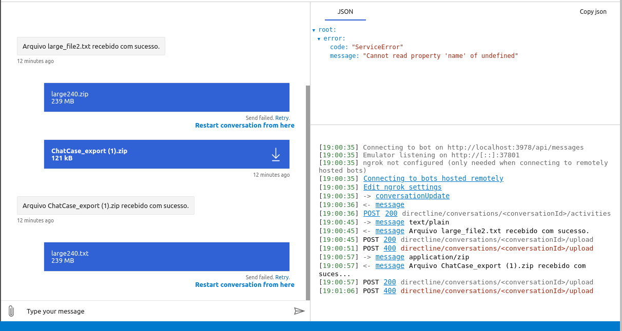

I'm encountering an issue when attempting to upload large files (specifically, files of size 238MB and larger) in the Bot Framework Emulator. While smaller files are successfully uploaded and validated, attempting to upload files larger than approximately 234MB results in a 400 error with the following message:
message: "Cannot read property 'name' of undefined"
code: "ServiceError"
I've thoroughly checked my code, and it functions as expected with smaller files. However, when attempting to upload larger files, the error occurs consistently. Unfortunately, I'm unable to retrieve any error logs as the message doesn't even get sent and remains stuck in the "sending" state.
Could this issue be related to any limitations within the Bot Framework Emulator regarding file size? Or perhaps there's another aspect I might be overlooking? Any insights or suggestions on how to resolve this issue would be greatly appreciated.Captura de tela 2024-04-22 191344

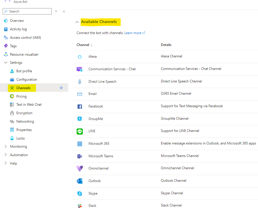

    Suggestion:
    Please try deploying your Bot Framework app to Azure and then add the channels from the Azure Bot resource. Then try uploading the files from that channel.
    Please check Bot Framework General Frequently Asked Questions and Send attachment(s) by upload for more details and here.
