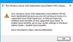

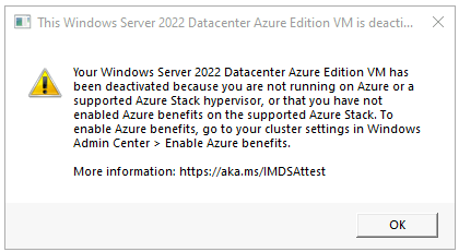

Windows Server 2022 Datacenter Azure Edition VM deactivated in MS Azure due to lack of "Azure Stack Hypervisor"
Petri Kaukua 100 Reputation points
2024-04-24T00:46:36.9433333+00:00
Multiple Windows Server 2022 Datacenter Azure Edition VMs started to give the following pop-up
serverdatacenterdeactivated
We are a bit puzzled as all the servers having this issue are in located in MS Azure (East-US).
We checked the connectivity to KMS and we are able to resolve the KMS. We can reactivate the servers successfully but after next restart the popup reappears and all servers are deactivated again.
What could cause the deactivation and how can we fix this issue?
