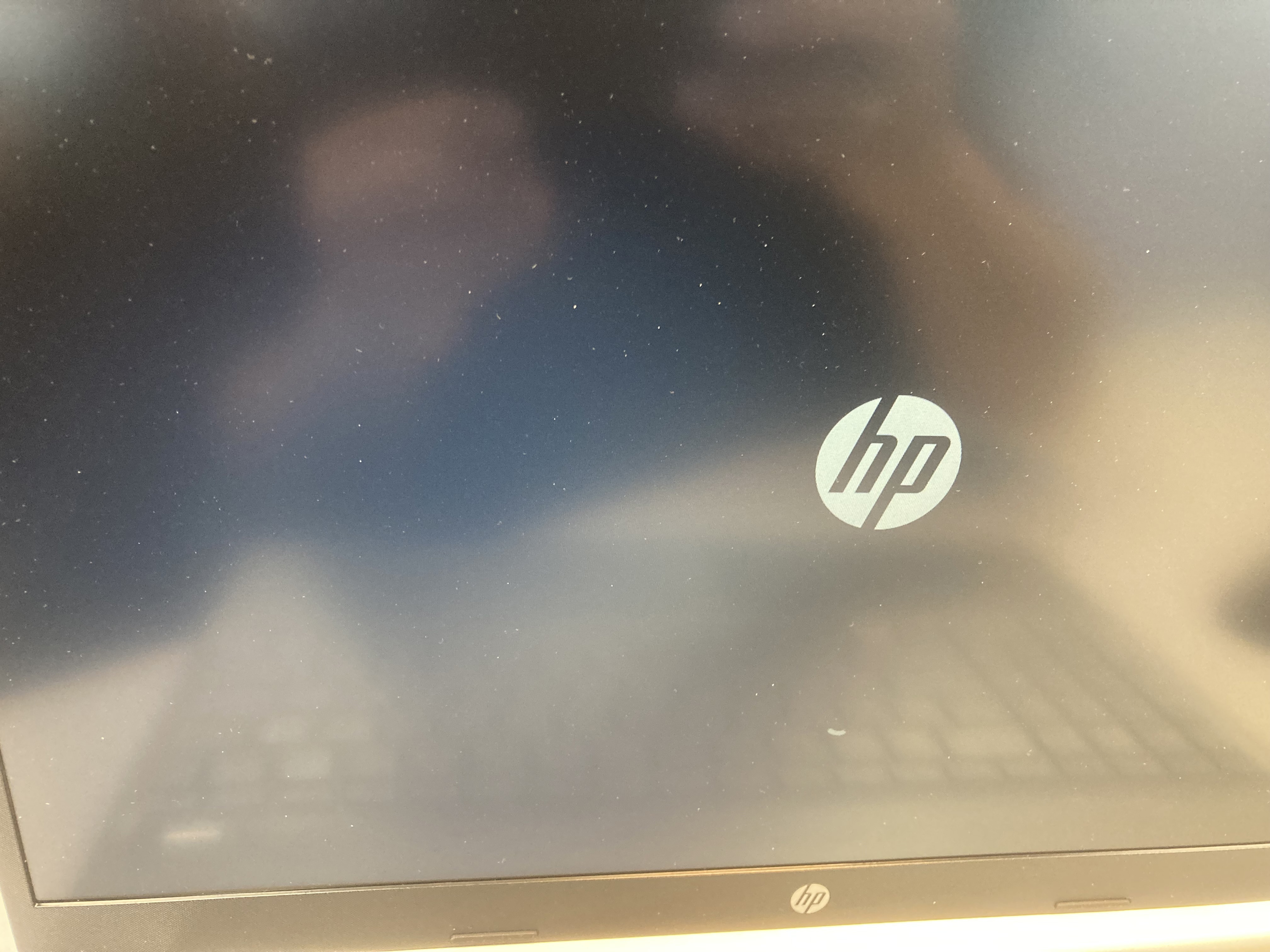

Hi all,
I want to setup hp laptop 15s-fq2934nd with MDT.
when the deployment is finishing installing the OS in step install operating system, the device reboots and gets the bsod with inaccessible boot device.
it stays in the loop rebooting with the inaccessible boot device
