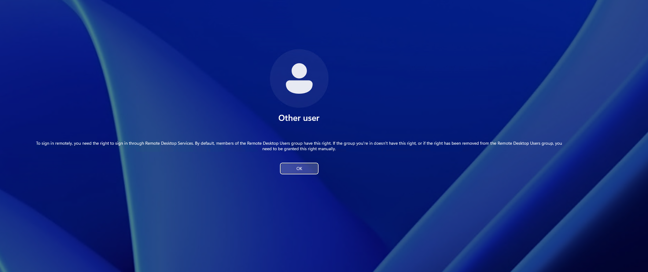

I have an On-Prem Active Directory connected to my Azure subscription via VPN Gateway.
All the Virtual Machines in Azure have successfully joined the Active Directory and work fine in terms of AD policy, rules, users, etc. The VMs in Azure are auto-stopped automatically daily after work hours.
My issue happens when the VMs are started the next day using a pipeline in Azure DevOps that runs Az Powershell against the tenant and starts up the VMs. Where some VMs, RANDOMLY, often not always, get the following screen on RDP: (Keep reading the post, the error message below is misleading, it is not a policy issue, it is rather a connection issue)
It seems like the VMs with this error message are unable to connect to Active Directory on-prem. But this is weird as other VMs did already manage to get the connection with Active Directory correctly. The solution to fix this issue is to restart the VM from the Azure portal and it will go back to normal and work fine. In some cases, we had to do the restart twice for the same VM, as the first start did not solve the issue. Basically, restart the VM from the portal until it has the connection back to Active Directory.
Also, in some cases, if a VNet has 10 VMs and all started in one PowerShell process from Azure DevOps, this problem happens to maybe 2 or 3 VMs, where the rest of the VMs work fine.
The issue happens often, not every time, not on every VM in Azure at the same time, it is kind of random and hard to spot and debug. But it happens often and it is starting to be annoying as we need to restart the affected VMs manually.
Any suggestion of how to go further and attempt to fix this issue?
