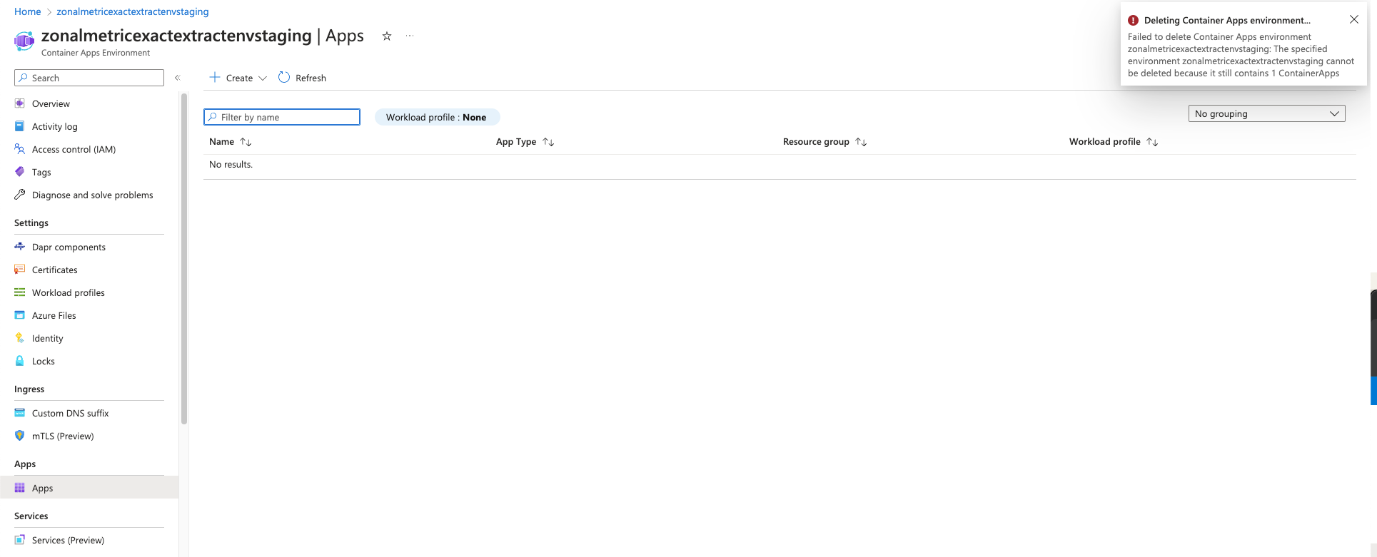

I am unable to delete a container app environment from azure. When I try to delete it, I get the message "The specified environment xxxxxxxxx cannot be deleted because it still contains 1 ContainerApps".
However, when I go to the Apps tab on the container app environment, I cannot see any container apps listed.
Although I cannot see any container apps listed under my container app environment, it seems that my container app environment has created a separate resource group that does contain a container app. I cannot delete this either as it has a read-only Deny assignment added that prevents me from being able to delete it.
In summary, I have a container app environment that I cannot delete as it is still linked to a container app which I also cannot delete.
This seems to be a bug in Azure. Screenshot 2024-04-25 at 17.14.36

  1. Rodrigo Dos Santos Barbosa 35 Reputation points
    2024-07-19T20:32:54.6033333+00:00
    Hello @Samuel Bradshaw !
    The builder is a different resource from the app container. When this happens, you must first remove the builder and then remove the app environment container. To check if you have a pending builder, list the resources associated with your environment with the following command:
    az resource list --namespace Microsoft.App --resource-type builders
    You will probably receive a response with a resource like Microsoft.App/builders. To remove it, run the following command replacing <builder-resource-id> with the builder id that you found in the query:
    az rest --method delete --url <builder-resource-id>?api-version=2023-08-01-preview
    The command will run in the background. Repeat the query until the builder resource stops returning. When the return is empty, proceed with deleting the app environment container:
    az containerapp env delete -n MyContainerappEnvironment -g MyResourceGroup
    And now you should be able to delete without any problems via command line or the portal. Be patient, as this command takes time to complete.
