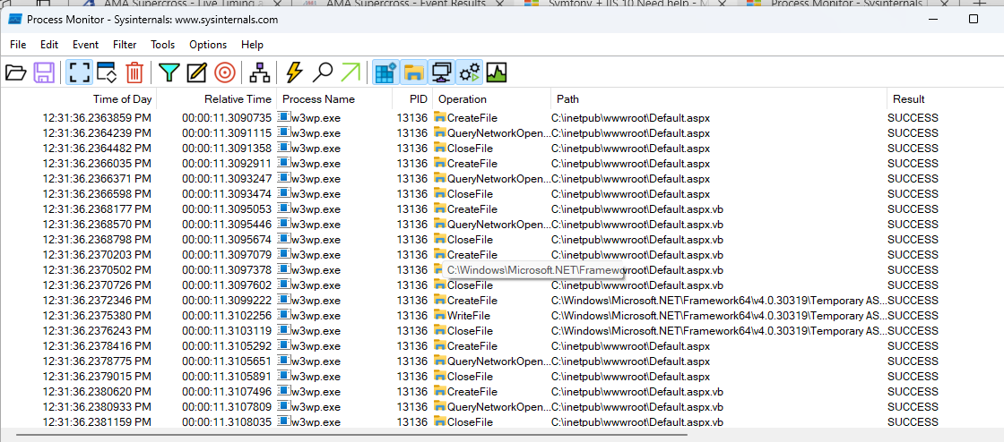

    Trace the call with Process Monitor.
    https://learn.microsoft.com/en-us/sysinternals/downloads/procmon
    Add a filter for "process name is w3wp.exe". Look in the Path column to see if tries to read your default document. Does the Result show SUCCESS or ACCESS DENIED?
    You might see "name not found" events as IIS looks for default.htm or default.asp which may not exist. That's normal.

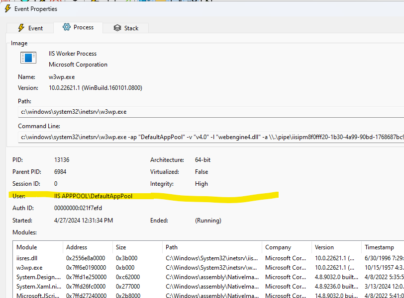

    Double click an access denied event and see what user account is referenced.
