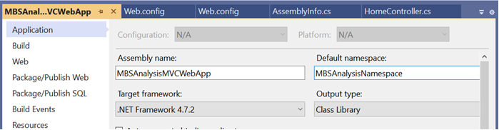

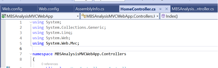

    After my testing, I guess you changed the name of your project?
    Please ensure that the namespace in MBSAnalysisMVCWebApp is consistent with the name of the using statement.
    In MBSAnalysisMVCWebApp
    In Mbsa
