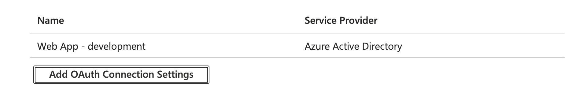

    I was able to get this working by adding an OAuth Connection Setting.
    https://portal.azure.com/ -> Bot Services -> {Bot name}
    In the side menu: Settings -> Configuration
    At the bottom of the page click Add OAuth Connection Settings.
    Choose Azure Active Directory
    Enter the client_id and client_secret from the App Registration that the Bot is using.
