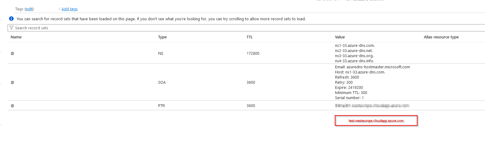

For Testing Purpose made a virtual machine and setup a Mail server. Everything form the Server Site and Access from external is working as planed. But to make i right i wantet do add a PRT record. so i created a Zone with an in addr record with the ip the vm received. I hat do errors. But when i check with mxtoolbox ptr i do not receive the record. Does anyone have any experiance with this?

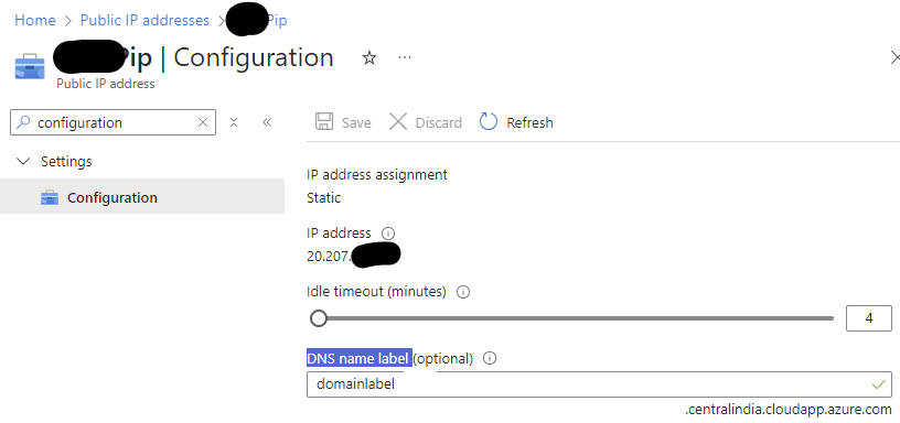

    I understand that you would like to add a PTR record to the Public IP of your VM.
    Please let me know if my observation is incorrect.
    For this to work, you must have a valid DNS name label configured in your PIP Configuration.
    • See :
      • User's image
    • Note : DNS name label provides A record and not PTR
    Once the above is done, you can proceed to configure the PTR record.

    What this states is that, (from my example)
    • You can add the PTR record as "domainlabel.centralindia.cloudapp.azure.com" to your Public IP or any Public IP in the subscription without any additional configuration.
    • If you want the PTR record to be a custom one, say "myapp.mycompany.com" , then the "myapp.mycompany.com" should resolve to your Public IP or any other Public IP in the subscription either via A record or CNAME record.
      • Only then Azure will let you add "myapp.mycompany.com" as PTR record.
    You can find the Powershell command here.
