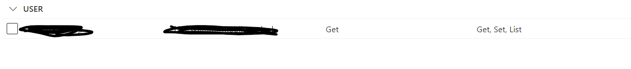

To debug the software, I'm using an Azure KeyVault which stores all connection strings (on a resource group specified for testing, which is a replica of the resource group for production). A user access policy is created in the KeyVaultrepresenting the programmer working with the testing resource group items. This has been working as intended for a year now.
Out of the blue, since yesterday 1530 UTC, this has stopped working for me. Visual Studio threw me a Azure.Identity.CredentialUnavailableException. Naturally, I assumed I had to log in again using Tools -> Options -> Azure Service Authentication. When this didn't work, I threw out the entire cache of VS and removed all users from File -> Account Settings, restarted VS and tried it again, to no avail. As far as my debugger is concerned, I am logged in properly, yet somehow I can't retrieve any KeyVault secrets. The options set in the Azure Key Vault of course are set properly.
Screenshot 2024-04-30 104508

  1. Umar 160 Reputation points
    2024-04-30T08:55:51.5866667+00:00
    Subject: Re:Azure Server Authentication mysteriously stops functioning since last night
    Dear Lucas Harskamp,
    Thank you for reaching out to us with your issue regarding Azure Server Authentication. I understand that you are using an Azure KeyVault to store connection strings for your software, and that you have a user access policy created in the KeyVault representing the application.
    Based on the information provided, it seems that the authentication issue could be caused by a variety of factors, including but not limited to:
    1. Expired or revoked KeyVault access policies
    2. Changes to the application's code or configuration that affect authentication
    3. Network connectivity issues between the application and KeyVault
    4. Issues with the KeyVault service itself
    To help diagnose the issue, I would recommend taking the following steps:
    1. Verify that the KeyVault access policies are still valid and have not been revoked.
    2. Check the application's code and configuration to ensure that no changes have been made that would affect authentication.
    3. Review the application's logs and any error messages that may have been generated to help pinpoint the issue.
    4. Test the application's connectivity to the KeyVault using tools such as Telnet or Ping to ensure that there are no network issues.
    5. Check the Azure Service Health dashboard to see if there are any current issues with the KeyVault service that may be affecting your application.
    If you have already tried these steps and are still experiencing issues, please provide us with more details about the error messages you are seeing, as well as any relevant logs or screenshots that may help us diagnose the issue further.
    Thank you for using Microsoft Q&A, and we look forward to helping you resolve this issue.
    Best regards,
    Umar
