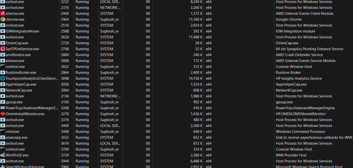

Sometimes out of nowhere the command propmt pops up and runs for few second and closes soon before closing it manually, and sum times the CMD will be runnning as a background process and will be using around a GB of RAM.
I had similar issue with windows powershell, turned out to be kind of malicious thing, have posted the issue here --> https://learn.microsoft.com/en-us/answers/questions/1349917/windows-powershell-suddenly-pops-and-uses-too-much
I suspect the same thing here but not sure what is causing the issue.

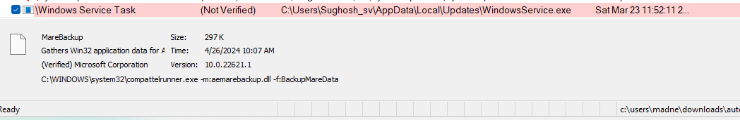

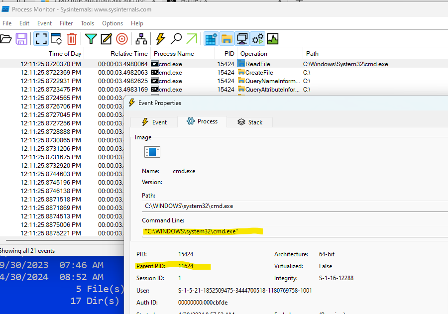

I have attached the task manager image and also the autorun log file(drive link --> https://drive.google.com/drive/folders/1kmL9-wC785d25ML3XW5hI2TS-GjuejLl?usp=sharing), please go through that.
  1. MotoX80 37,161 Reputation points
    2024-04-30T16:31:48.55+00:00
    I don't see anything in your autoruns files that stands out as questionable.

    Download and run process Monitor.
    https://learn.microsoft.com/en-us/sysinternals/downloads/procmon

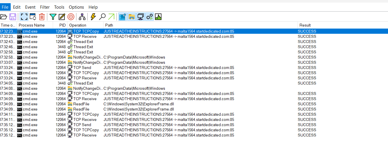

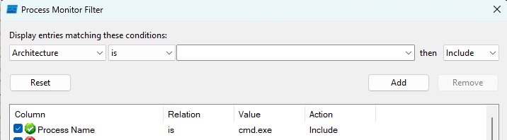

    In the Filter menu add an include entry for process name is cmd.exe.
    Trace the issue and look for the process. Double click on an entry. Does the command line entry point to some .bat file? What's in that file?
    Note the parent PID. That will help you find out how/what launched cmd.exe. Use the task manager to find that PID.
