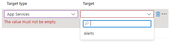

However when I create a static web app and try and use this as a backend target it does not appear in the below "target" area no matter which settings I toggle (please note that the gateway is the correct V2 SKU).

    So when I PowerShell the process, in the portal it adds in the app however it doesn't show as an "App" but as a target IP/FQDN not App service. Please note again for the below point I am using a static web app.
    If I add in (for example) a function app then it shows in the drop down (as below) so I am thinking that this option probably does not work for static web apps - however if you (or anyone) has been able to achieve this then I am all ears as to what the issue might be.

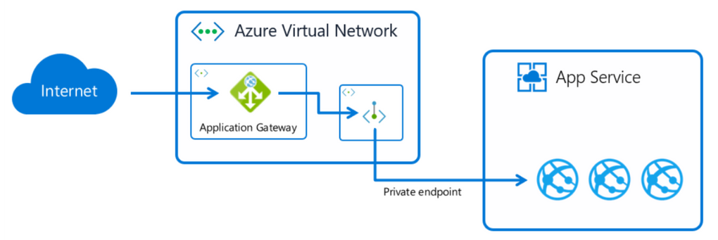

    Just for reference regarding the secondary question above "masking the backend" (webapp) FQDN, I have been able to achieve this with a combination of the following 2 configuration steps:

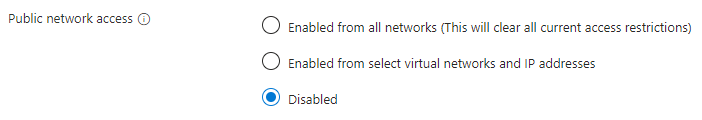

    Web application (Networking/Access restrictions): Disable this setting and disallow access from public networksUser's image
    This setting disallows any access to the FQDN of the web application (Azure FQDN) from public networks.

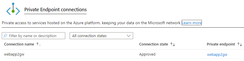

    Private endpoint:
    A private endpoint connection from the web application to that linked to the Application gateway.
    Most of these details can be found here: https://learn.microsoft.com/en-us/azure/app-service/overview-app-gateway-integration with network diagram below.

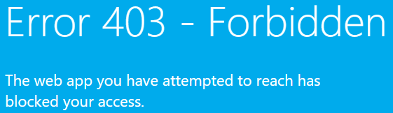

    As per the above guide this blocks any access to the web application with a 403 forbidden allowing access via the FQDN linked to the front end of the application gateway.
