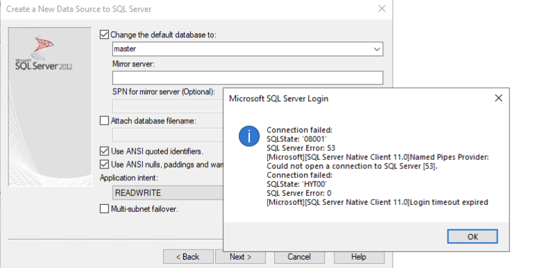

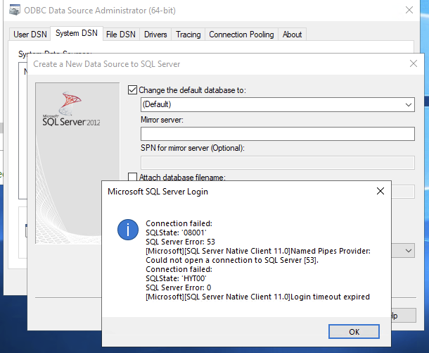

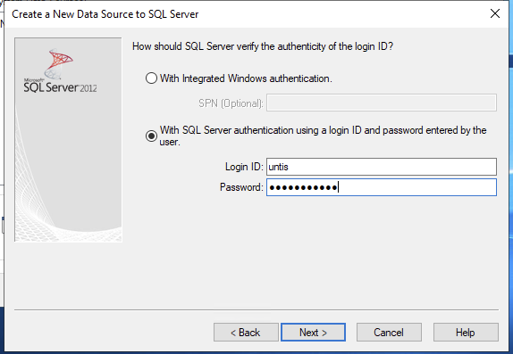

Named Pipes Provider: Could not open a connection to SQL Server error (53)
from public facing Server to Local SQL Server but Local to DMC Server possible
Please any one can you advice to me

    Typically that means that you were not able to reach the SQL Server instance you were trying to reach. There could be any number of reasons for this:
    • SQL Server is not running.
    • Misspelling of the server and/or instance name.
    • Firewalls in the way.
    And the list goes on.
    You can try this troubleshooter.
