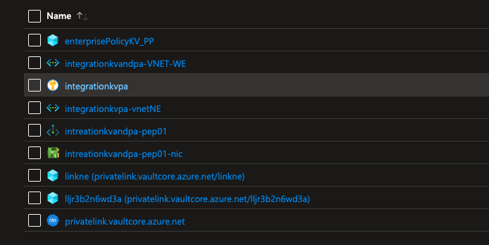

This week, I've been trying to configure my Power Platform through a KeyVault to got some secrets, using a private networks by hardening the external access. The tutorial followed is this one: https://learn.microsoft.com/en-us/power-platform/admin/vnet-support-setup-configure#set-up-the-virtual-network-and-subnets where the steps took were "How to run Subnet Injection scripts" https://github.com/microsoft/PowerApps-Samples/tree/master/powershell/enterprisePolicies#how-to-run-subnet-injection-scripts
The funny thing is all resources were created, not Power Shell Script threw errors creating the following Azure resources

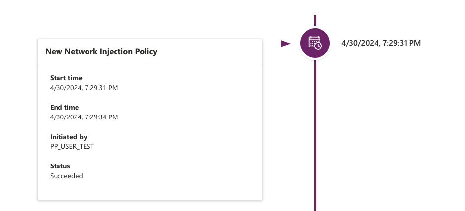

Plus, the Power Platform history is saying that I've configured the connection

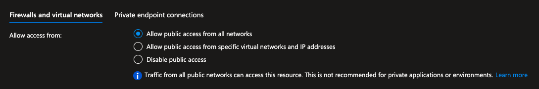

  • If I am opening the KV network: the flow worked

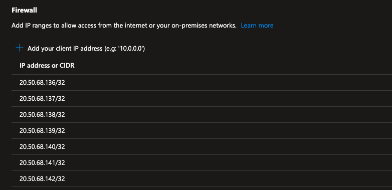

  • if I am adding the Allow public access from specific virtual networks and IP addresses and I am adding the thousands Power Automate public IPs, is working https://learn.microsoft.com/en-us/connectors/common/outbound-ip-addresses. But I'd like to avoid this solution adding thousands of IPs and apart from that I 'd prefer not to be updating them.

    Thank you for taking the time to respond,, following the links shared, and also trying to have a workaround for this topic, I've been creating a JS script to be executed by NodeJS, where taking the file: ServiceTags_Public_20240422.json (https://www.microsoft.com/en-us/download/details.aspx?id=56519), it's creating a PS1 Script to run the KeyVault command to add the network rules. Since allowing public access from specific virtual networks and IP addresses I should manage the region IPs where I am running the Power Platform Infra, and it's a big list.
    Shared the code below

    Now my Power Automate Scripts are working as expected by adding the 2 Power Platform region IPs.
