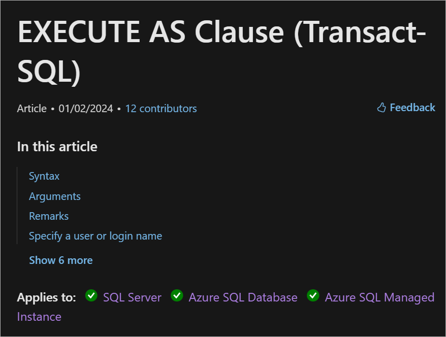

When I execute the SP as the testuserY, I receive the error 'The INSERT permission was denied on the object' for this user. I read on Microsoft document around EXECUTE AS Clause but I don't think it applies to Synapse dedicated pool.

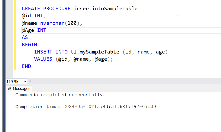

    What you have would work fine in regular SQL Server, thanks to something known as ownership chaining. That is, when a module accesses an object that has the same owner as the module, there is no permission check at all. However, it appears that this is not implemented in Synapse Dedicated Pool. I also found an old thread which suggested that this may come in the future: https://learn.microsoft.com/en-us/answers/questions/528220/idea-suggestion-is-it-possible-to-support-ownershi. But that was three years ago...
    Unfortunately, I cannot think of a solution that would meet your requirements. (But I should add that I normally do not work with Synapse, but I hang around with the regular SQL Server.)

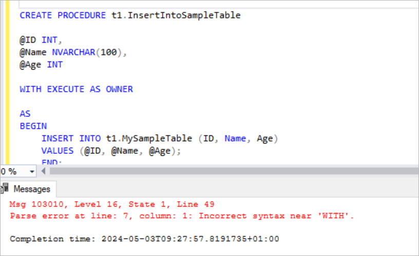

    Try to use EXECUTE AS OWNER to enable the SP to run with the privileges of the SP owner (typically a higher-privileged user) even if the actual user executing the procedure has no direct permissions on the underlying objects.
    CREATE PROCEDURE t1.InsertIntoSampleTable
    @ID INT,
    @Name NVARCHAR(100),
    @Age INT
    WITH EXECUTE AS OWNER
    AS
    BEGIN
        INSERT INTO t1.MySampleTable (ID, Name, Age)
        VALUES (@ID, @Name, @Age);
    END;
