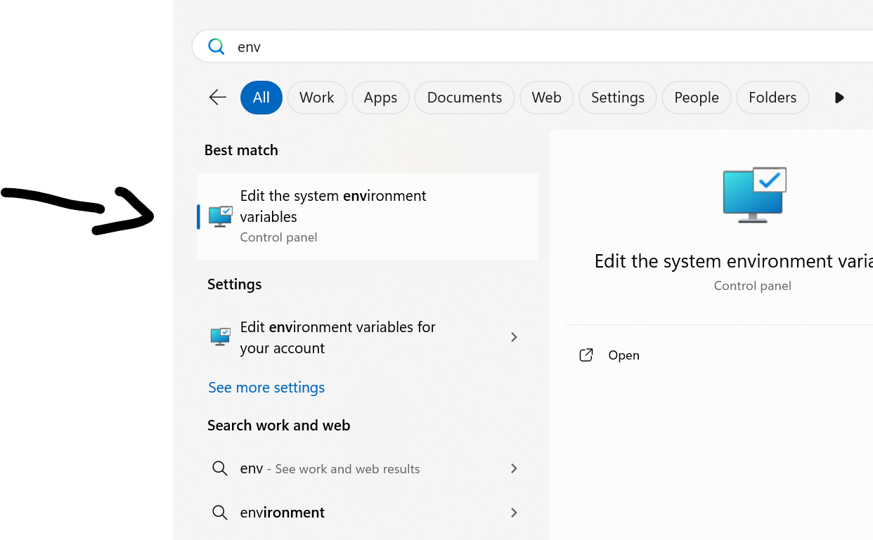

    1. First, Install NuGet package You can download the latest recommended version at https://dist.nuget.org/win-x86-commandline/latest/nuget.exe. https://learn.microsoft.com/en-us/nuget/reference/nuget-exe-cli-reference?tabs=windows
    2. After you downloaded the file on your local folder, copy the file path.
    3. Go create a new folder in your C drive named it Nuget, double click on folder name and copy the path.

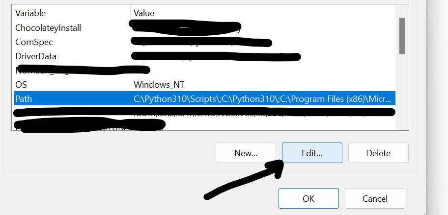

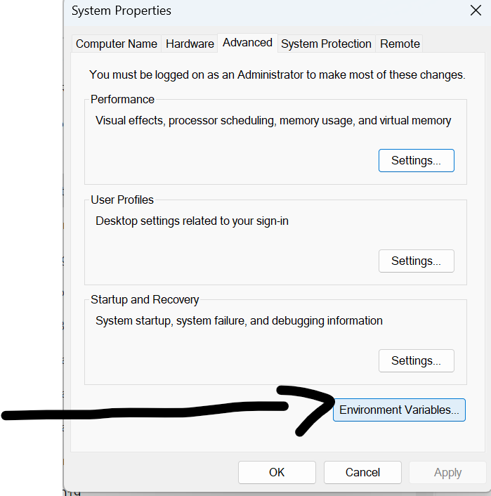

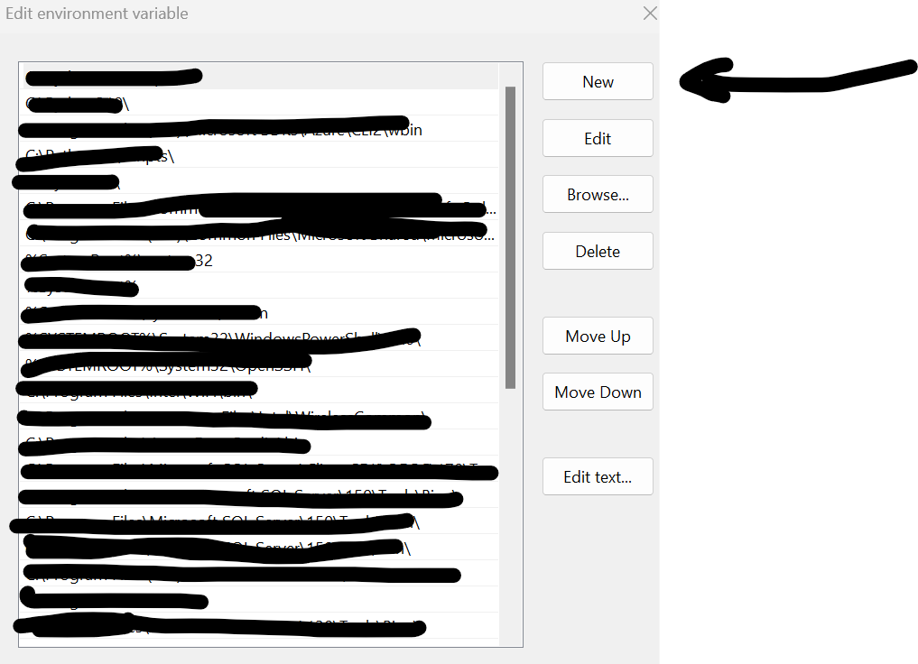

    4. In the Environment Variables section (type it in the sear, find the Path variable and click Edit.
    5. Add the path to your desired directory (e.g., C:\path\to\your\directory).
    6. Restart any open Command Prompt or PowerShell windows for the changes to take effect.
    7. Right click on the file name from the folder to open the cmd shell or PowerShell
    Hope that will help you.
