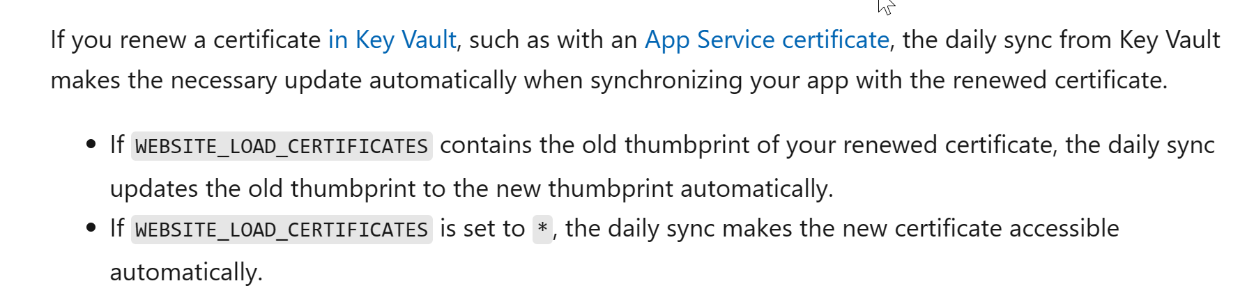

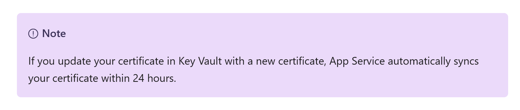

    It is clearly called out in the documentation here, that if you update the certificate in keyvault App service will automatically sync the certificate within 24 hours.
    For more information you can refer to when updating(renew) a certificate section in this documentation.
