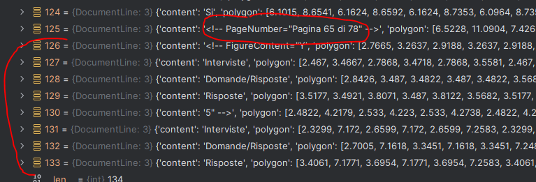

If the original document contains a footer with the page number, a specific tag with the detected page number is reported in the Markdown result.

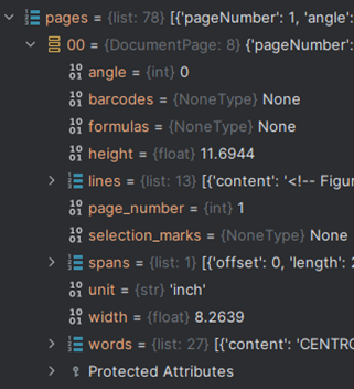

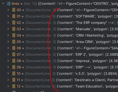

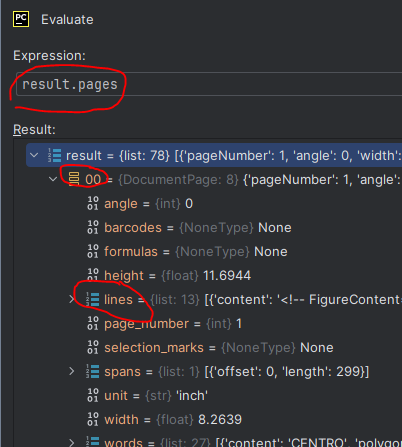

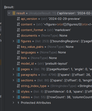

Analyzing the JSON structure returned by the Document Intelligence service I saw that a subdivision of the document into pages and lines is returned for each page.
(screenshot in python code)

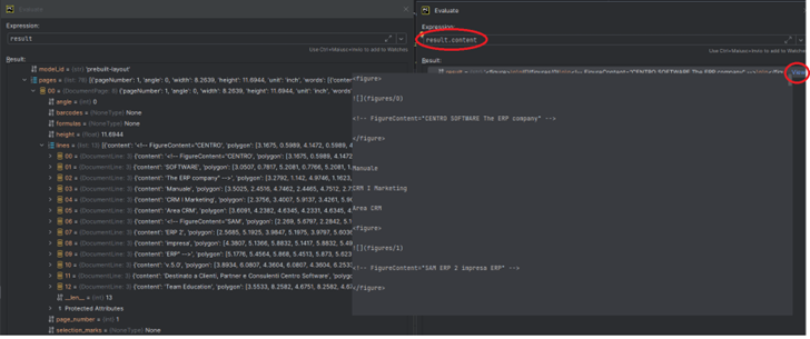

I tried to rebuild the pages using the "content" property of lines elements, but the textual result is not the same as the entire text in Markdown.
Furthermore, it happens that if a page ends with a table or an image before the page footer with the page number, the page number does not turn out to be the last actual line of the page, this makes it difficult to structure an algorithm to identify the end of pages in the result in Markdown
