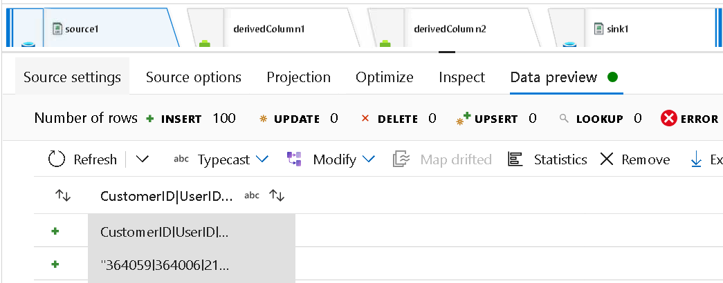

I was planning to use copyactivity to load files from sftp location to datalake for archiving as well as upserting in deltalake. However, I am getting error while reading from source, as some file has delimiter (|) in the value itself and there is no escape character.( I cannot change the source data)
Solution :

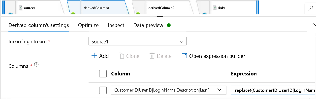

I thought to read the file without any delimiter so that all the value will be in a single column and then load in same format in datalake. Then use dataflow to read from datalake source and use replace () to replace delimiter (|) to hyphen and then split the values to multiple columns and make it similar to source csv.
1 . using no delimiter option in the dataset to bring all the column value in single column.User's image
  1. Now , I am replacing the delimiter present in the value with hyphen Ex - replace ('aaaa|bbb','aaaa-bbb'). I know the exact value having issue.
  2. Then, splitting the column into its original columns.

  2. When using above solution, then In the 3rd step , I have to give the column names with expression split (col,'|')[1],split (col,'|')[2].. Can we avoid giving columns names and do it dynamically so that if any other file have similar issue then I can just use this dataflow with some parameters.

    For your second question, you can use dynamic column mapping in the data flow to avoid giving column names. You can use the "Derived Column" transformation to split the column into multiple columns dynamically. You can also use parameters in the data flow to make it more flexible and reusable.
