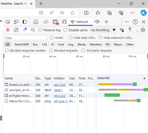

ASP.NET Web Form site worked fine in test. I moved it to production and the site won't come up. I've done a reinstall and double checked all I could. I looked for an answer into this and came away with it being a browser issue when it is not that as this happens to anyone looking at the site. The site uses SSO, but it doesn't even get to that point and it generates the error in the title on the very first hit in the Network tab when I do an inspect. Test site is 2022 while the production server is 2016. Framework for the production site is 4.5.2. I know production has at least 4.6, but I would find it odd if the difference would be the issue.
