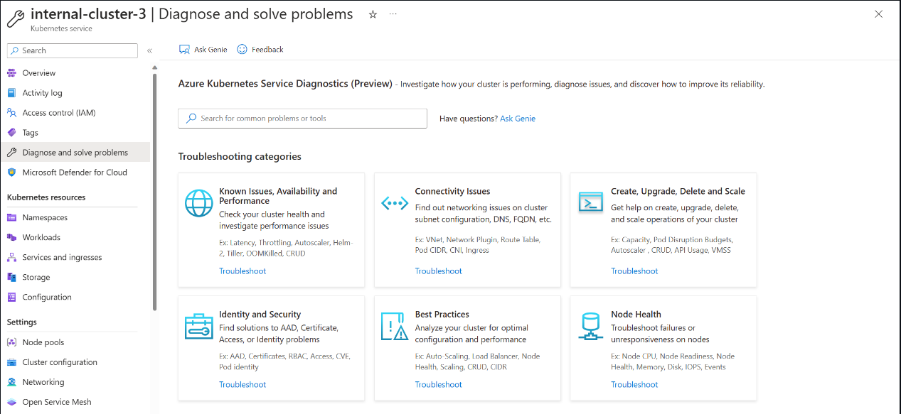

    In Azure Portal:
    User's image As shown above,
    1. Navigate to your AKS cluster in the Azure portal.
    2. Click on Diagnose and solve problems in the left navigation.
    3. Choose a category that best describes your issue.
