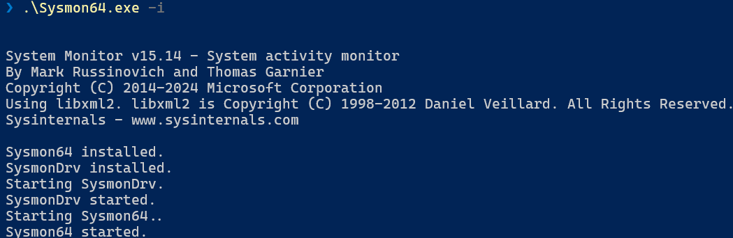

    did you install Sysmon by running sysmon64.exe -i?
    If Sysmon is installed you could verify if the service Sysmon64 is listed under Services and status is running.
