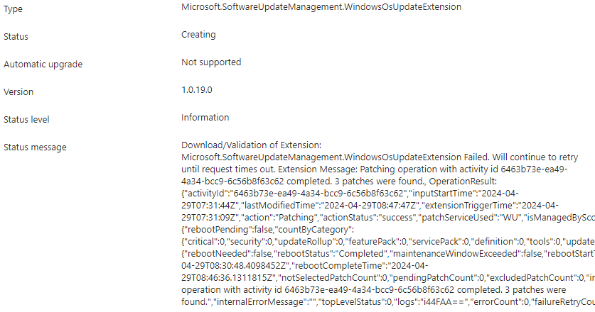

I've recently started having Windows computers failing with update assessments and patching in Azure Update Manager. I did some investigation, and I see that the "WindowsOsUpdateextension" for the servers is in a "Creating" state. The version was going from 1.18.0 to 1.19.0. I do not see any files for the new version on the computer in the "C:\Packages" folder. And the error I can see in one of the logs is below. I have not made any firewall changes that should affect the ability for the files to download/install. Any help you can offer will be appreciated! This is happening to about half of my computers now. User's image

  2. Alan Kozarian 15 Reputation points
    2024-05-09T18:01:10.7133333+00:00
    This issue is resolved. On one of the affected Windows Computers, the WindowsOSUpdateExtension install eventually showed as "Failed" in the Azure Arc Portal. I was then able to choose "Uninstall Extension". After a few minutes, it uninstalled. I then went back to the Azure Update Manager Portal for the device, and initiated a manual assessment (Check for Updates). Once I did this, the WindowsOSUpdateExtension install was automatically started, and completed successfully per the Azure Arc Portal. I did this for the remaining Windows Computers that had the same issue, and the are all working now. I am thinking that the "Fix" was that the download locations used for the Extension Install were updated to include all of the needed/correct files. Thanks for your help on this!
